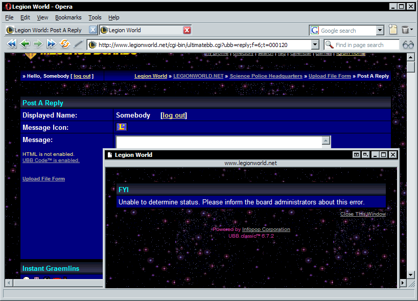

Thanks for turning this back on. Unfortunately, the "Upload File Form" links result in "FYI: Unable to determine status. Please inform the board administrators about this error."
The same is true for the Upload Manager that I linked to above, but that function doesn't seem to have a visible link anywhere when making a post, this time around. (The File Form link is run from a JavaScript.)
I can look at my already-uploaded files from your test of this two years ago, at this location (the last 8 digits are one's user number). It doesn't seem that anyone else has been able to store files since then.

#370485 08/08/06 05:37 PM
*tests*
Same error message.
EDIT: Okay, this is weird - I just tried a couple of alts, and one got the message, but the other one worked:

It's not a browser issue, Changeling, it's a server issue. And, given that the alt that worked is the most "junior" alt I have, whereas the alt that didn't is nearly as old as this account, I suspect it's the earlier (2003) memberships that are disproportionately affected by this bug...

EDIT: Well, an late-Jul 2003 alt (less than 20 posts) works, but this ID and an early-Jul 2003 alt (greater than 50 posts) don't.

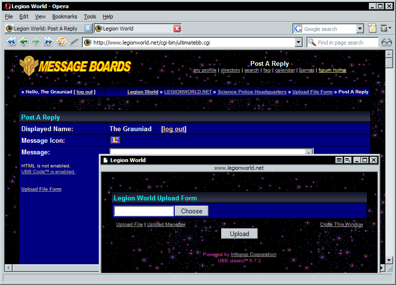

Well, I get a "FYI - Unable to determine status. Please inform the board administrators about this error." as Reboot and Somebody. The other IDs I've tested so far work (yeah, the screenshots are in Opera, but that's just convienience. Same whichever browser).
